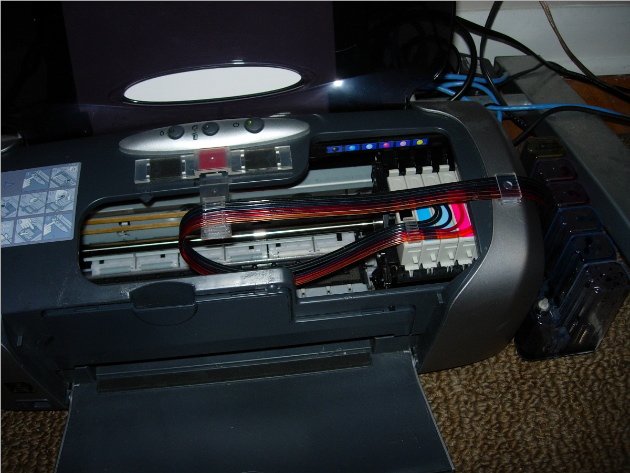

    Thanks to Macrovision, I got my CIS from JLW Sales routed correctly! This morning, after two months of error free printing, during the course of printing a DVD the tubes got caught under the cartridge and I heard that horrific SCREECH!!!! Oh man, I hate that sound. I tried over and over different configurations and nothing I tried worked. I felt like I was killing my r200 with all that screeching. I had my CIS routed like what is on the 1st page of this thread (I had electrical tape attached to the tubing inside the front of the printer). That seemed to do the trick for 2 months.
    This morning when I came across Macrovision's post, I liked how he did his routing, however I didn't fully understand it. Thanks to him (for e-mailing privately to further explain), I got it figured out. Like he stated earlier, it really is quite easy. However, when you don't have instructions or someone telling you how to do it, it can be confusing (at least to some people like myself). Until today, I had not idea what to do with those clips that JLW Sales gives you with the CIS system. For 2 months they've been sitting in the box that the system came in (thank goodness I didn't toss them!).
    Well anyway, just for anyone who is looking to route thier CIS system, I strongly recommend doing it this way. It not only is easy but the tubes won't get caught under the cartridges now! The only negative (and a very slight one at that) is that my cover won't close flush. It closes almost all the way down, but raises just a slight bit (I don't imagine I'll ever care, because it's very minor).
    Here is a pic...
    ** By the way, I probably have a little more slack than what you would ideally want. Since taking this picture, I've pulled about a half an inch of the tubing to the right so now there isn't as much slack but just enough so that the cartridges can go all the way to the left (when printing cd/dvd's).

    IF YOU SEE THE PIC ABOVE NOTE THAT i INFORMED NICKELZY THAT THE TUBING IS HANGING A LITTLE TOO MUCH BUT IT IS EASY TO CORRECT...JUST PULL THE TUBING BACK AT THE SMALL CLIP UNTIL IT'S NOT BLOCKING THE CARRAIGE....IF YOU BLOCK THE CARRAIGE MOVEMENT THE PRINTER WILL GIVE YOU AN ERROR MESSAGE....THE INK AND PAPER LIGHTS WILL FLASH AND THE EPSON MONITOR WILL READ "GENERAL ERROR" NOT ONLY DO I HAVE TECHNICAL TRANING (REPAIR) BUT I'VE TAKEN THE R200 APART SO MANY TIMES I CAN DO IT IN MY SLEEP PLUS I'VE SEEN MANY OF THE ERROR MESSAGES.......I ALSO KNOW ABOUT THE WASTE INK PADDING...HOW TO CLEAN IT AND BEWARE...IF YOU DON'T KNOW ABOUT IT'S GEARS DON'T SCREW WITH IT....THE PRINTER ALSO MONITORS THE PARKING OF THE HEAD TO IT AND IF IF DOESN'T MOVE AT THE RIGHT TIME IT WILL GIVE THE "GENERAL ERROR" MESSAGE!!!! GOOD LUCK!
    Here is a pic...

    As you can see from page two, this setup has already been used by 'tonyiws'. Have'nt seen any post's from him for ages, wonder how he is getting on with it.
    Originally Posted by tonyiws
    Here are some pics of how I have the tubing routed. The placement of the clip on the tubes prevents them from being pinched when the cover is closed. I used the spine of a dvd case for the cross support. It is just hot glued in place. The tubing is held to the cross support with double sided tape.

    we used the routing clips supplied and we dont worry about the tubes being pinched because the routing arm keeps the cover slightly raised and its perfect....no hot glue needed...no extra supplies to buy... were using whats supplied and that's all folks

    the photo that nickelzy took you can see the center of the "T' routing arm...it's red...this peice is raised if you notice....it's what's stopping the cover from pinching the tubes....the smaller clip is supposed to be on the far right(grey part)to support the tubing so it doesn't bend and stop the ink flow...anyway if the routing arm wasn't supplied then I would improvise like tonywhatever's :P

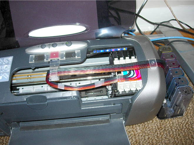

    Just a follow up from my pic above, after pulling the tubes more to the right, my routing looks like:
    And I agree 100% with macrovision; if you have the clips like I have shown in the picture (which are included with CIS systems purchased though JLW Sales as well as some other suppliers), why configure it any other way? What is shown above is how it was intended to be routed and more importantly, it works perfectly!
    By the way, the white pieces on the ink hose is just tape. With all of my earlier problems (before configuring the routing like above), the hoses got split in two spots which is why I taped them together so that they don't flap around while printing.
