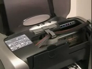

    I bought another cis kit but this time it came from printonadime.com. The tanks come with ink but the carts are not primed...it has an instructional cd that shows all you need to know but the tanks are so small that when I primed the carts it used all the ink from the tanks....I'm gonna mod my jlwsales cis kit with newer carts... My new kits auto reset chips don't allow the printer to do a cleaning...Ever ...when the printer is first turned on. And they auto-reset when levels reach 10%.... I noticed a funny thing....The routing clips are identical to the JLWSALES routing clips but JLWSALES doesn't give instructions on how to install the routing clips...I'm so amazed at how it works I converted the windows media clip into mpeg video and used my windvd program to take pics... I hope it can help you guy's that want guidance....P.S. I print with the top down and no problems...It's so simple a child can do it and there's no danger for the hoses!!!!
  23. Member
    Mar 2005
    Hostile Territory
    I think I uploaded the photo wrong let me try again
  24. Member
    Mar 2005
    Hostile Territory
    If you noticed the routing clips are the same as the jlwsales routing clips...you have the top piece and must connect the middle piece to make the letter "T"...feed the hoses through the top and put on the bracket to hold the tubes in place...what you don't see in this photo is to the far right there is a smaller clip with double sided tape on it(included in the jlwsales kit...it's meant to be mounted on the edge of the printer(gray part of the top casing)to secure the hoses..."remember not to allow more of the hoses than needed inside of the printer"(only enough for the print head to move to the far left)It's not gonna get caught if you follow the instructions and you can close the top without worries...one more thing I have to get some sleep because I got a full day tommorrow but when I get home I'll post more pics and maybe the actual video to "HELP ALL" but I have to slice the vid up because this forum has a 2mb limit and the vid is almost 6mb...I LOVE MY NEW CIS KIT!!!!
