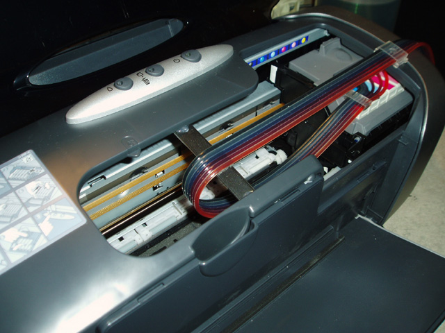

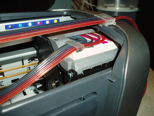

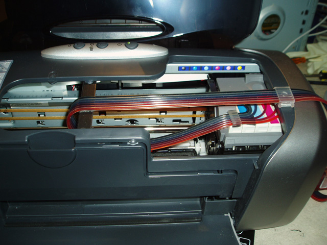

Here are some pics of how I have the tubing routed. The placement of the clip on the tubes prevents them from being pinched when the cover is closed. I used the spine of a dvd case for the cross support. It is just hot glued in place. The tubing is held to the cross support with double sided tape.

I originally had mine setup the same way. The problem was that when printing dvds/cds the printer moves so fast that sometimes the tubing would get caught on the cartridge for some reason. It would also cause the tubing to go up and hit the cover, causing it to pop up sometimes.Originally Posted by tonyiws
Has anyone noticed any difference in the print quality when printing photos?
On which side of the cross support was it getting caught? The way I have it setup, the tubing is pulled tight between the side of the printer and the cross support. It doesn't droop down and touch the print head. When the print head moves all the way to the left, there isn't much extra tubing to go up and hit the cover. Because the tubing is attached to the cross support everything seems to stay in place nicely. I have only printed about 10 discs with it setup this way. I'll let everyone know if I have any problems.Originally Posted by dmagic1
