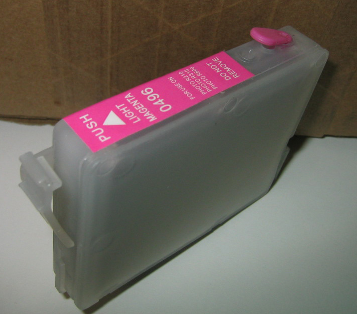

  25. I got my replacement Light Magenta today and the cart is completely different. It has 3 hole on the top. One has that weird pink stopper in it. The other 2 holes are actually closed a little below the surface level. The cart is an almost clear grey. The cart seems to already have ink in it. I don't know how well this cart will sit with the others. The others have the tube attached at the top. This one will have the tube attached at the bottom. I think this design is better because if you keep the grey cart holder thing on your cart tray, the tubes would be out of the way. Although if this had been the black cart I don't know where the tube clip would go.
    No instructions were included.

  29. dmagic... I just wanted to mention that I have replaced my light magenta with the exact same replacement cart you received in the mail. It works flawlessly. Actually, I dont think it will clog either. It seems to be made completely different. One other note is that (again with the hot glue), after I reattached the hose, I added some hotglue to hold it into place. After you get your cart installed, I think you will be very happy. I have replacements for all my carts except black. JLWsales really is great at customer service.
