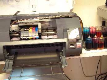

  7. This system has been awesome for me. I have printed about 400 - 500 disks and my resevoirs are ALL just above half. I rarely print documents or pictures.I never turn the printer off
    (for ink savings). I have had the system about 3 mo. give or take. Never a problem .......but the routings of the ink tubes took some time to think of the best way. My method in previous post (link)pics seems to be the best..... at least for disk printing people.

  10. Originally Posted by Bodyslide
    Where's the link?
    2 pics below
    http://members.cox.net/layhay/epson%20setup%202%20moving%20001.jpg
    http://members.cox.net/layhay/epson%20setup%202%20007.jpg
