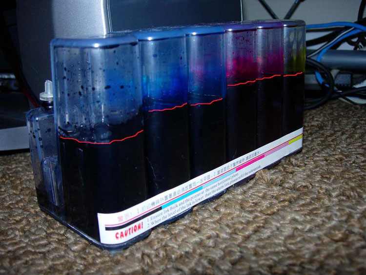

    Feb 2004
    Thanks for the info, Dmagic. I understand your point about printing pictures, particularly on the best photo mode (which is what I was using). However, it looks like in one day of printing, my large color chambers have been decreased by about 20% and my black one by about 30%. If this system is equivalent to about 6.5 cartridges worth of ink, then that would mean roughly, I used over a set of cartridges worth of ink yesterday. No way did I do THAT much printing - no way! That's why I'm trying to make sense of this. Again, like I asked before, when the cartridge that resides in the printer first is used, does it fill up completely to begin with (which would take a cartridge amount from each chamber?) If that's the case, and I actually have the ink that is in each chamber, plus a full amount of ink in the cartridges (that are in my printer), that might make more sense. Do you follow?
    Just for kicks, I took a pic to show where my ink levels are after 1 day of using the system. I highlighted in red to show exactly where the ink levels are in each chamber.
    By the way, my question about turning the printer on and off is more of a concern of whether I'll decrease the life of the printer if it remains on 24 hours a day 365 days a year.
  18. The carts should have been full and should still be full. They shouldn't have been empty when you first got them.
    To be honest after using this system for almost 3 months I can say that it uses ink faster than normal carts. I was refilling carts for sometime before getting this system. I was still on my original bulk ink order when I got this system. I have since ordered some bulk ink 1 1/2 times(1 times all 6 colors, 1 time only 3 of the colors). I also have to keep in mind that I started printing alot more after getting the system, but I can tell that it does use more ink.
  19. There's clearly an issue with that much ink consumption. I'd check around for leaks. For all the levels to drop simultaneously to that degree, it seems like you'd have to be doing a lot of cleaning cycles.
    I don't know how there could be a leak, because there isn't any excess link on my floor nor is there any in the printer. Therefore if there is a leak, that would be one heck of mystery to me because there is no ink to show for it. As for your comment regarding running a lot of cleaning cycles... actually, that you are right on. I had some issues installing the system and due to not properly securing the lines, they got tangled a couple of times causing the cartridges to malfunction, which led to some printing and subsquent quality issues. In order to resolve the problems and get things back to where they originally were, I did several maintenance tasks, including about 5 or 6 cleaning cycles. Now that I finally have everything properly installed, secured and running fine, there shouldn't be a need for any further cleaning cylces, at least not for a while. With that all being stated, could the simple fact that I ran 5 or 6 cleaning cycles be what caused THAT much ink consumption? Although I needed to do them in order to correct some problems that I had yesterday, I never realized that the cycles would be using an enormous amount of ink. Do you REALLY believe that this is what caused my huge ink loss? Good to know, if that's the case, for future reference.
