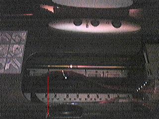

  16. Can you post some pics of your setup buckeejit?

    How far away are your cartridges from the printer? Mine are almost touching the right side. Your tubes might not be long enough with how yours are positioned?

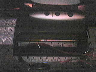

  18. ok here's 2 pics, sorry about the quality. they were taken with my phone.
    ah crap, I dunno how to attach the pics :S how dumb am I?

    Looks like the clip might be hitting something on the left side of the printer. Also the tubes themselves might be hitting the printer cover to the left. Maybe move the clip back to the right just a bit. Make it sit flush on the cartridges.

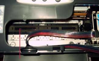

  22. Looks like too much tube.
    Tubes when folded and completely straight shouldnt be past this red line.

    I was thinking the same thing.

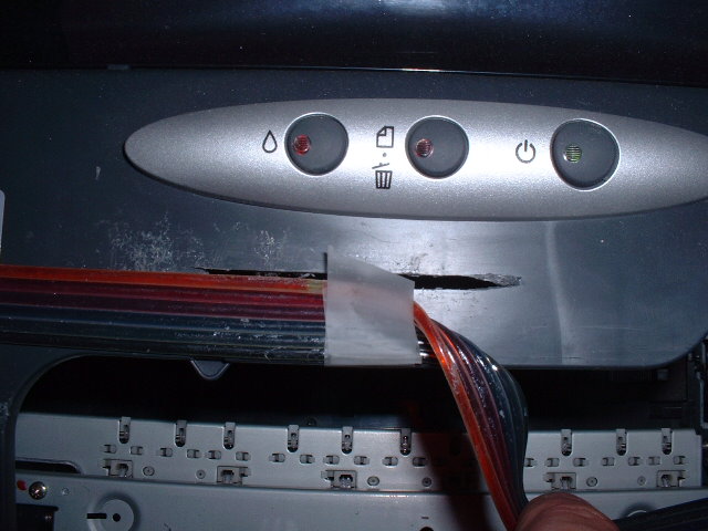

  24. ok ill try this method of uploading photos.... http://members.cox.net/layhay/epson%20setup%20003.jpg after much duck tape and a couple months of use i have finally got it set up this way. It seems to be the best for me. I cut a slot with my cordless circular saw so i will use a zip tie to hold the tubes there. Just tape for now.http://members.cox.net/layhay/epson%20setup%20002.jpghttp://members.cox.net/layhay/epson%20setup%20004.jpg

    Never thought about running the tubes up top.
    Here's the link to your photo.
    https://www.videohelp.com/forum/images/guides/p1216547/epson%20setup%20002.jpg
  26. Notice if I fold my tubes completely straight they would reach the red line.

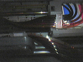

  27. How does your carriage move to the left?
    Got a shot further back?
