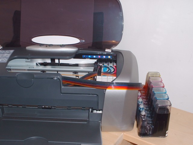

  3. I bought this system an got it delivered to New York in 3 days. Seems great so far. Quality of the product and the results are super. Install is simple. The ink tank was the reason I opted to buy this system after looking at others available. Two chamber ink tank prefilled. The tank has air vents to remove any air in the tubing lines. Works great so far. I thought the double sided tape was weak from the start so I bought some 3M Super Strength Mounting Tape to replace what it came with. Followed directions and used alcohol to clean contacts. Awesome so far. If you are even thinking of buying it, buy it you will be glad. I knew it came with 100ml of each color (equal to 10 cartridges) but was surprised at how much ink that is. The JLW sales on ebay also sells ink refill for $45 delivered. Don't know when I might need that, but I will say printing color DVD's, photos or whatever color is fun now that it is cheap. Can upload some photos if interested.

    Thanks for the pictures and the very detailed info, it seems to be a very good product. I think I'll be ordering one pretty soon. I want to be able to print as many pictures and cd as I can without having to worry about the cost of ink, I guess this system can do that. I also don't want to refill every time a cartridge runs out of ink.

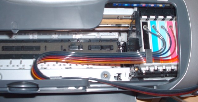

  13. Here is my install shots. Right now I have electrical tape on it. I will be using something stronger once I'm sure I like the spot.

  15. I don't see how he could say that. You cant close the thing down with the tubes in the way.
    Even the included Japanese instructions show the removal of the ink cover but the shorter English instructions doesn't mention it.

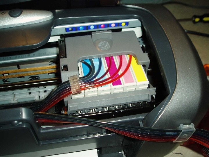

  18. dmagic1, attached is image of system installed without remove ink cover from Tony whos of our member
  19. Cant see your picture.
  20. Sorry I don't know how to upload the image, here 1 more try
  21. Hmm, I personally don't like how the cover sits on the tubes.
  22. He claimed it work. I'll try w/o remove cover if does not work then go with your way. Again thank a bunch for your help.

  24. Yes, without the cover some how the cartrigdes are too loose, chips don't make a good contact (printer did not regconize the cartrigde) in my case.

    Hi all... I'm the guy that locky has been talking about that left the cover on. Actually I took it off first, then decided to put it back on because I was concerned that with nothing holding that end of the carts down the chips would not make good contact. I did not try to use it without the cover, so I can't say it was actually a problem. It is a pain trying to get all the carts threaded through the hole in the cover tho...
    As far as pinching the tubes is concerned... I have not had a problem with it. I have been using it heavily for two days so far. The ink levels in the bottles are dropping as expected.
    The only thing you have to do to get it to work this way is reposistion where the tubes are attached to the black cart so the cover will close.
