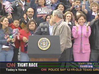

    This post is for historic record.
    (NOTE! Still fine, this is a reference to my ONE AND ONLY "loading" experience).
    Again, this is the only time I have ever gotten "green goo" on my screen.
    Four conditions to remember about this:
    - It was the day I recorded 24+ hours non-stop.
    - This mess is ONLY on my CNN and a few other channels on my cable.
    - This only happens during the first 1-2 second of the disc.
    - This happened only on the last couple of discs, before it faulted to "loading".
    The only two frames with green boogers:
    The JVC will misbehave after extended, continous use. Then again, all of my VCRs, including even the expensive $400+ decks, will eat tapes too after about 12 hours of non-stop use. Nothing new to video electronics, not at all.
    This is the visual goop you'll likely get before "loading" hits you. It is almost undoubtedly something to do with power management. This is not a common issue, but common enough that a good handful of people have experienced it. Remember, even in clinical trials, somebody usually dies.
    Something to watch for.
