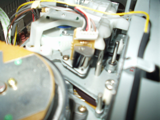

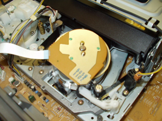

Here's the latest:
1. I opened the unit and it was impressively clean - not even a speck of dust in sight, let alone remnants of peanut butter sandwiches
. All looked in good working order.
2. The heads (is that the big silver rotating drum that's on an angle?) looked clean. I have to confess I didn't clean them because of this. I bought some window cleaner as suggested.
3. None of the tapes that are played "too fast" in LP mode are wrinkled at the bottom, or anywhere - they're all perfectly unspoilt.
4. When playing, the tape appeared to be running OK through the guides (the two upright white things that pull the tape around the head...). See Pic 1:
5. I forgot samijubal's warning:
...and cleaned (with the window cleaner) and adjusted the sensor to one side of the head - the one that is on a sprung arm that moves if you push it (see Pic 2 below), otherwise seems fixed in place. NOT the other sensor which is permanently fixed.Originally Posted by samijubal
This sensor appears to be made of a vertical silver element (see Pic 3 below), and a vertical black element. Adjusting it seemed to do the trick until the symptom came back again later in the tape. But, until then, it was perfect (and so much better than before). I'm guessing these are the audio / control heads as adjusting the various screws affected the audio and the playback speed.
The problem is, I think I've fiddled too much (a very strong suspicion) with the audio control heads as...
a) Recording in LP mode shows that I can only fit 7.5 hours on a 4 hour tape (should be 8).
b) Although recording and playback are now OK - playback of tapes recorded in LP mode before I fiddled are all at fast speed all the way through. So, unwatched programs are hilariously unwatchable.
...resulting in my girlfriend asking why I couldn't "just leave it alone and get a new one?". Fair question...
So - I reckon that the audio / control heads required ever such a slight tweak (as opposed to my heavy handed adjusments on all three screws).
My question...: What can I do to recover this poor abused VCR, if anything?
I'm guessing (hoping) that it'll still be usable as long as I stick to recording and playing back stuff, and just giving up on any recorded programs "pre-fiddle".
Thanks...There is some corner of a foreign field that is forever England: Telstra Stadium, Sydney, 22/11/2003.

Adjusting the audio head is a last resort, you're in for some fun now. All I can say now is listen to the audio while adjusting the head, when you hear the most treble in the audio, that's when it's close to right. The audio/control head adjustment is very sensitive, may take a very long time to get it right. The guide to look at is the guide past the audio head, see if the tape is centered in that guide, not the guides that load the tape around the drum.
Yikes.
It's going to be a bit difficult now to get it back to the way it was, if you don't have a tape path alignment cassette and an oscilliscope. I don't suppose you know anyone with one...hmmm. Didn't think so.
Is there any way you can remember how far you turned the screws, and which ones? Going by the assumption that it was properly aligned to begin with and only just needed cleaning, if you could get it back to where it was before you started it would help.
The drum which you mentioned was clean, is actually quite hard to see if it has been clogged with the naked eye, as the heads themselves are quite small. They are just a tiny chip at the lower part of the upper drum assembly (the rotating part) and there should be at least two mounted 180° apart from each other. To clean them, you should use chamois and not a q-tip or similar, as it can snag on the head and break it.
Other than what samijubal suggested, I don't know of any reliable way to get this unit back into proper alignment easily. The method he suggested is "trial and error", but what else could you do at this point, next to taking it to a tech? (or returning it to where you bought it for an exchange, if that's possible).
I wish I could suggest something beyond that, but once the alignment has been changed, all bets are off. Try the trial and error method, and let us know what you come up with. *crosses fingers*Ethernet (n): something used to catch the etherbunny -

@ samijubal & Roundabout - OK, are you ready for a good chuckle...?
Yes, that's easy - all of them to the full of extent in both directions (i.e. completely tight to removing the audio / control head from the unit to have a look).Originally Posted by Roundabout
OK, I'll pause while you regain your composure and get back on your seats...
After quite a bit of fiddling about - trial and error fitting samijubal's description - (without "a tape path alignment cassette and an oscilliscope" - I've lost touch with my old physics teacher...) I finally got it so that it'd record and playback OK - but only for playback of recordings made "post fiddle". Anything recorded before I tampered still plays fast.
Cheers for the info on what the heads look like and where they're located - I know exactly what you mean. I wondered what those little rectangular holes were...
And I'll also look at the correct guide.
Thanks gents, I'll report back with my next findings and I'll promise not to touch anything...

Speed problems aren't coming from the drum, so cleaning the video heads won't do anything to fix the problem. Look at the solder connections on the audio head and see if any of them look bad. You can try unplugging the plug from the main board and plugging it back in, once in awhile they aren't making a good connection. You can try the same thing at the head assembly itself, but it's more delicate and if not careful you could do more damage than good. Your speed problems are at the audio/control head, connections to it, or something related to it since this is what picks up the signal to control speed.
The 3 pictures I posted don't show it, but the connections at the bacl of the audio / control unit looked OK - I made a point of inspecting them.Originally Posted by samijubal
OK, I'll see if I can give that a go - I did try that (but not too hard coz I'm heavy handed) and it didn't seem to want to come off, that's why I unscrewed the whole unit (D'Oh!Originally Posted by samijubal
I'll have a closer look and a more conerted effort...
