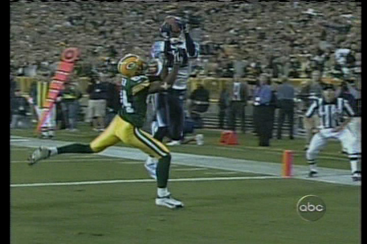

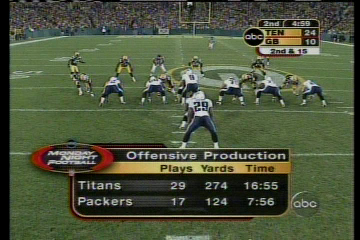

    I saw this thread earlier and decided to pull out my old Dazzle and fiddle with it a bit. (I was really bored, what can I say?) Anyways....here's a couple stills from something I captured off the TV tonight using my Dazzle.
    Note:
    Mine is the DVC-100 model, and I am using the MovieStar 5 software that came with it to capture with. This model is USB 1.1 not 2.0 like the newer ones. The PC was a 1.33 Athlon T-Bird, 1GB ram, Windosw XP Pro and I was saving the captured MPEG file on another network PC linked through a router. I did it that way because I only have a 4.3 GB hard drive in that PC, and the MovieStar 5 software only works with Win98 and XP but not Windows 2000 for some strange reason, and my main video PC is running Windows 2000.
    Anyways....there ya go.

    I looked at those screen captures, and know that my ATI beat those using IUVCR as the capture device. Using powervcrII and capturing to CVD (with 48mhz audio), I got some really good captures, however, in all fairness with rapid moviement, you would see a ghosting effect.
