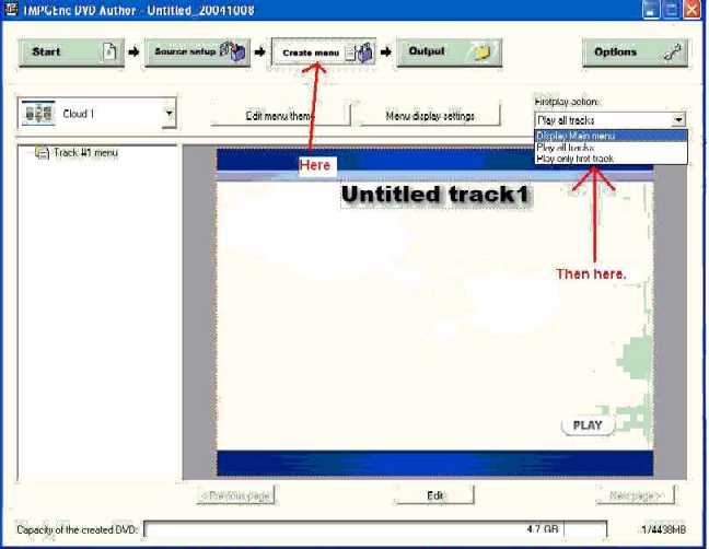

Bizuser> where is the option to take off play video first and go to the menu?
Thanks again all -
See picture below.Originally Posted by venomva
