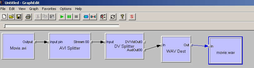

Here's how I do it in Graphedit. Insert the Wav Dest filter and connect as shown below. Insert the File Writer filter, name the file Movie.wav, click on open. Then join the pins from Wav Dest to Movie.Wav and hit the green play button. This will save the audio out to the Movie.Wav file.

Well I got it to work, but not without incident. First off, the file is misrecognised as 32Khz 16-bit, not 12-bit as I reported yesterday. This is what I found:Originally Posted by Safesurfer
If I first use the filter chain as you supplied the file is written as 32Khz SR.
If I run it again the output is still 32Khz SR.
If I render the avi first in graphedit, play it, close graphedit, reopen it and then load and run the wav extracting filter graph, it outputs a 48Khz SR file and on subsequent runs it remains 48Khz SR.
When it is misrecognised, I see 48Khz as the Audio output format from DV Splitter's AudOut00, but 32 Khz at Wav Dest's In pin.
So it appears to be an initialisation problem.
