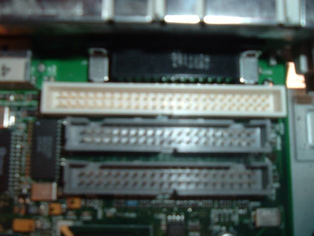

Here's something that I want to make sure of with the G3. Which of these should I have the IDE cable that goes to the main Hd in? I only have IDE cables for the bottom 2, the top one is too big. This seems redundant but I just want to eliminate all possible options. Thanks.

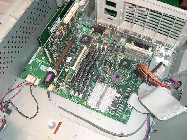

Here's one of the mother board and PCI slots too.
Hrm... not sure if you really want to run OSX on that G3, and I'm thinking depending on the model it might not run at all.
does it not say on the board somewhere which one is IDE1 and IDE2...or IDE0 and IDE1 depending on how they labeled it? -

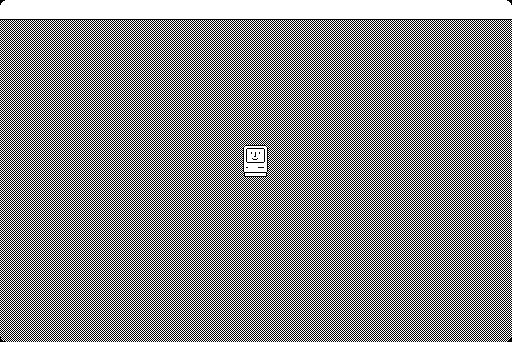

My latest analysis with the G3 is that it for some reason simply will not boot from the 10.2 disk. When I put the disk in at startup and hold command c, it will boot up and try to recognize the disk. For a split second it will show this screen:
indicating that it recongizes the disk, and then the screen will flash and it will reboot. I have tried an external usb cdrom too, but I don't think its capable of recognizing this. Since I had 10.2 running on it fine before for several months I don't think its a compatibility issue. Does someone know of a live-cd for G3 ppc that I could try, or any other suggestions would be appreciated.
