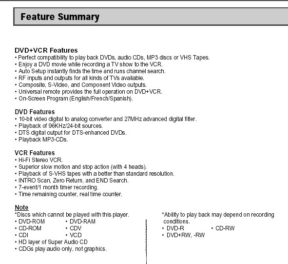

  2. Originally Posted by RickTheRed
    I've looked in the unit manual and it was written that this model was not able to play DVD-ROM.
    I doubt it.
    Pressed DVD's have DVD-ROM booktype written on them.
    In this case it would not play any original disc.
    You could have some bad reflectivity DVD+R's or the burning speed was too high

    Here is a picture from the manual saying that it cannot read dvd-rom.
    I've looked in other samsung manual and the same thing was written.
