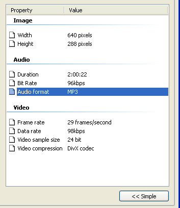

I am trying to convert and author the following file in DVD Workshop 2. I have had no luck and i think it is because of the resolution. Would anyone happen to have an ideas on the best way to convert this for authoring?

Just wondering if anyone knows if I need to convert the resolution before opening this file up in DVDWorkshop 2? If so, how would I convert the resolution???

try www.thefilmmachine.com to convert your avi to an mpeg that can then be used to "convert" to dvd. The issues that I see are the audio and resolution not being dvd compliant. you can try to repatch them, but you'd probably be better off converting them to a valid dvd resolution. There is a low rez avi to vcd conversion in my signature. You could gleen some info from that that would assist in getting it converted (fyi valid dvd resolutions are -NTSC- 720x480, 704x480, 352x480).
