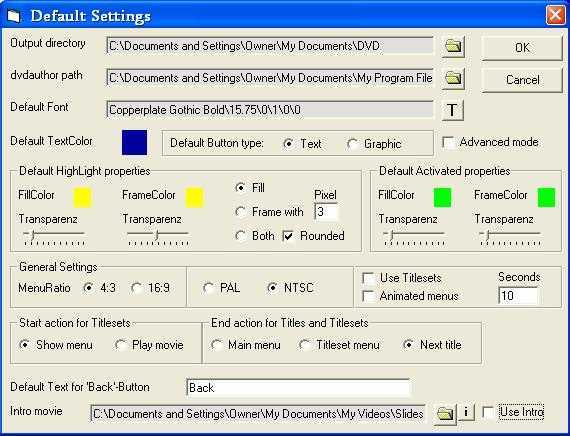

So let me see if I understand your situation right:
1. You use TMPGENC for your mpeg2 d1 or 1/2 d1 encoding?
2. You cannot click the Create button, but its not grayed out
It looks like this:
First open Def. Settings with a blank project. Then make sure that you have specified the DVD Author.exe path, and the output folder. I'm also guessing that you want NTSC (USA Video). Here is my window, yours should look the same except don't worry about the directory of the intro file:
If that didn't fix the Create Button Problem, try using the Create Batch button. This will create a bunch of files including Author.xml and MainBatch.bat. You can edit Author.xml to change settings of the dvd, but that is probably unimportant to you at this time. So if you can get Create Batch to create these files in your folder, open the mainbatch.bat file, which will then create your dvd.
I hope this works!
