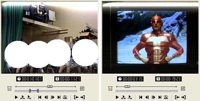

    It's very similar to a tracking problem but it's not. Here's an example, non MV to the left, MV to the right.

    No I mean I have played back the file from the PC into the TV out from the card and the results are the same. The Dangio OVA looks the same as the tape quality wise. I'm playing the file back into the TV not the VHS tape.
    Here's what Im dealin with -
    Torn picuture
    Blurry still
    Dark Title Open
    Project Digital: Eliminate All Physical Media is finally underway!
    You are screwed.
    This is Macrovision. It was copied onto the tape.
