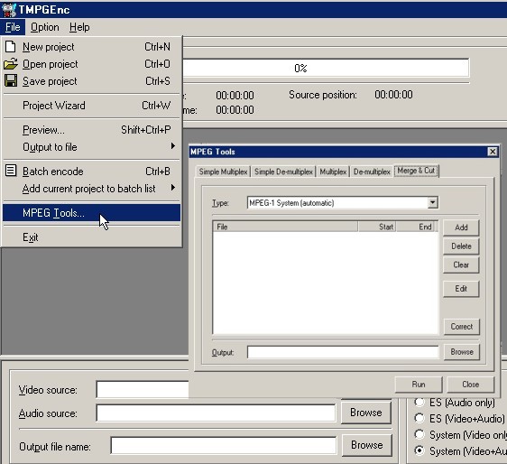

Use IsoBuster to convert DAT to MPEG and TMPGEnc to merge and encode.
ISOBuster Guide
