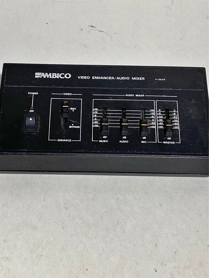

    yea i believe that was a component but for example the copythis has an enhance knob on it. I found one unconventional use for one on my Odyssey 2 which had a composite mod installed. The mod when hooked up to my Extron composite switcher wouldn't display a picture.. basically just black.. but when going directly to the tv it would show a picture.. so the copythis managed to somehow boost the signal so the extron would pick it up.. but aside from that, I wasn't sure if devices like this would do anything.. i was considering yet another sima product that is one of those video mixers.. and it has a few audio volumes but it also has "enhance" on it..
    and yes you're right upon closer inspection the knob on the copythis is a "video output signal adjust" which i figured was basically the same thing, but now i'm questioning that.. and the copymaster has no knobs at all so yea that one most likely i imagine simply defeats the copy protection.. but it would make claims of improving the picture, but i don't think that was it's strength without allowing any user adjusting..
    [Attachment 60186 - Click to enlarge]
    I just wanted to see if a device like this would deliver a respectable enhance effect or if maybe you had to get higher end stuff to get one that made a difference.

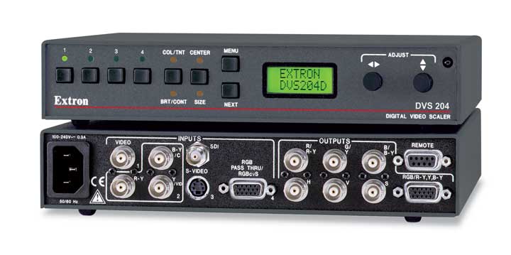

    those look interesting.. and you've made me realize.. maybe i have something already.. I have The Extron DVS 204 Digital Video Scaler. This has some whistles and bells.. I wonder if it does any enhancement.. ok.. finds manual.. pulls this up.. but i wonder if this is the same enhancement we're talking about?
    [Attachment 60194 - Click to enlarge]
    Enhanced (Enh) mode
    When the Enhanced mode is set “On”, automatic gain control of the video input
    signal is enabled. If the input signal level is too weak, the signal gain will be
    increased, and if the input signal level is excessive, the signal gain will be
    decreased
    Seems like automatic gain control is bad? like don't we want to adjust? or maybe this is like compression with audio.. something that just helps keep a dynamic video balanced by adjusting faster than the human eye could manage?
