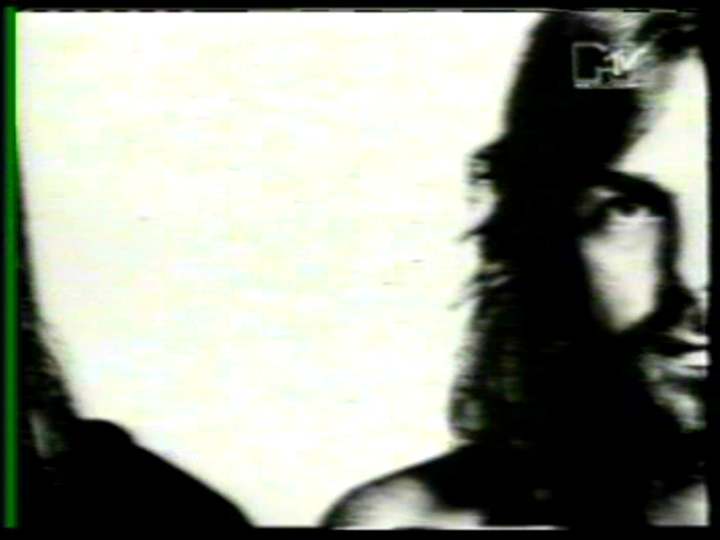

I'm working on archiving some vhs tapes. They have what I would call "comets" that seem to appear at random all over the image. I need advice on what filters to use in Virtual Dub to reduce the "comets". I have a 17MB clip at www.pigs-on-the-wing.com/scene0002.mpg captured at 720x480 but encoded to mpeg at 352x480 4000bps CBR. I will only have the clip up for a day or two as I do not want to overload the bandwidth of the person hosting the clip for me.

Is this MTV USA from the mid 80s?
I have plenty VHS tapes from 88 - 90, that looks exactly like this. But they are from MTV Europe.
Those "comets" you see. are analogue satellite noise.
Not much to do. Try "temporal filtering" at a high value. But that way, you won't be able to frameserve! Also the motion gonna be a bit ghosty, so better use a chain like: deinterlace (unfold) - temporal smooth ( 5 - 6 ) - Deinterlace (fold).
At the same chain, try also the "frame merger" filter. But as a secondary filter only and don't set it more than value " 2 ".
You need also some sharpening there. Try MSU_Sharpen filter. Excellent but slow.

SatStorm may be right. It looks like interference. And the video tape is from Europe I believe. I will try your suggestions and see how that works out.
