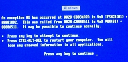

    I can't seem to find anyone else reporting a windows crash once they tell DVDAuthorgui.992 to actually start authoring. my only hunch, based on other DVDAuthorgui-related posts, is that maybe this GUI just doesn't like w/98.
    The error I get says (essentially): exception 0E has occured @....
    in VxD IFSMGR(01) ... called from .... in VxD in VMM(01)
    Can anybody shed any light on this problem?
    Thanks.

    could you elaborate on the "typical FAT32 problems"?
    is that my problem?
    once, it took a minute before the BSOD kicked in, and
    I got a small box in the upper left corner titled "oldapp",
    if I recall correctly. This is my first attempt at attaching
    a jpg to one these posts...here goes.
    thanks for the help!

    no, by typical fat32 problems, i mean filesizes are restricted to 4 gig in size, so i doubt seriously if thats your problem. I did a quick google check, and discovered a lot of different things are associated wit hthat error:
    http://www.google.com/search?hl=en&lr=&ie=UTF-8&q=ifsmgr+win98
    IMHO, it sounds like you are dealing with low resources, dvdauthorgui (like most authoring programs) is not very 'resource friendly'.
    One thing i would like you to try is: In the dvdauthorgui directory, there is a 'process.bat' file. Run this by itsself (It should bring up a dos window). Let me know if the process runs correctly, or if it brings up that BSOD also.

    yep, process.bat gets created (along with menu.xml & config.xml)
    before everything freezes up; and after I reboot, if I open a DOS-window
    and run process.bat, everything is processed and the resulting files give
    me a good burn. If I didn't have to reboot to run the .bat I wouldn't
    complain, because the software works great, otherwise.
    Before running your GUI, I close down all my TSR's.
    I'm using a duron950 processor with 512Mb RAM.
    thanks, again!

    Im still investigating the problem, but im not really getting anywhere. I just verified that the gui is working correctly under win98se. (I authored a small dvd on it and it worked correctly). This leads me to think it has to be something specific with your system. (Either a hardware or software problem). When you say, 'TSRs', what background applications do you have running? (antivirus, popup blockers, etc).
