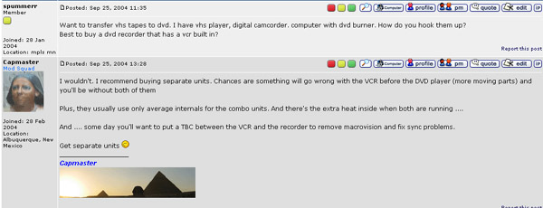

  1. Want to transfer vhs tapes to dvd. I have vhs player, digital camcorder. computer with dvd burner. How do you hook them up?
    Best to buy a dvd recorder that has a vcr built in?

    I wouldn't. I recommend buying separate units. Chances are something will go wrong with the VCR before the DVD player (more moving parts) and you'll be without both of them
    Plus, they usually use only average internals for the combo units. And there's the extra heat inside when both are running ....
    And .... some day you'll want to put a TBC between the VCR and the recorder to remove macrovision and fix sync problems.
    Get separate units

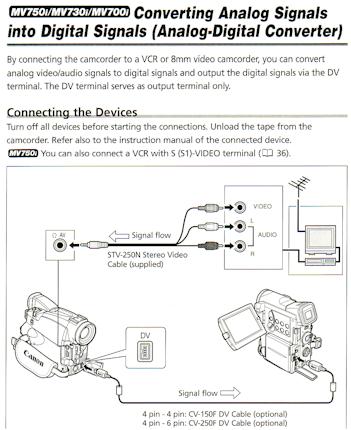

    If the cam is digital it will have a firewire port also known as I-Link or 1394, it should be labled and found right near the RCA jacks. You need a firewire cable ($8-$15) to run from your cam to your computer. There it needs to be hooked into a firewire port. If you don't have one you need to purchase a PCI firewire card which costs about $15 and up.
    From there you need software, I suggest Ulead Video Studio as it pretty easy to use and produces some decent results. It will go from capture to burn. There's also many free software tools available in the tools section to the left. You may already have software on your computer for this, most DVD burners come with DVD creation software.

  10. Camcorders vary a bit on the video input. You'll probably need a cable something like this to go between your VCR and camcorder:
    http://www.ritzcamera.com/products/525050431.html
    Such a cable probably came with your camcorder.

    First choice. Connect your camcorder to the firewire inputs of your VCR. If it doesn't have firewire inputs, and it probably won't, the next best thing is to use an s-video cable. If you don't have the right connectors on both, then you can use composite (yellow RCA connector).
    No composite? Then get equipment that's compatible so you can transfer from one to the other.

    I don't know of any VCR that has Firewire output. Most don't even have S-Video. He's probably going to have to use composite to go from the VCR to the Camcorder, Firewire from Camcorder to Computer.

    Completley different, it's like plugging it into a usb port. It's a lossless transfer, you copy the file from the cam to your HD. There's no digital conversion or capture required although it is reffered to as capturing. Analog has to be captured or converted to digital format.

    Yes if he wants to capture his VHS tapes and his cam supports passthrough. But not for the cam only.

  19. I hooked up the camcorder to the vcr with S video- Didn't work- Then tried standard cables. Still didn't work.
    I'm trying to play the vhs tape, and copying it on to my digital camcorder. Maybe you can't do this?? I don't know
    Once it's on the camcorder I can put it in the computer.
    I need help getting the vhs to record on the camcorder. Thanks

    The jacks on the cam may only be for output, you'll need your manual to find out. You could look it up online or it may say right next to them output.

  26. One more time. I HAVE a vcr, Digital Camcorder, Computer with a DVD burner.
    I want to transfer the vhs tapes to the camcorder so I can load it on the computer.
    My question was how do I hook up the camcorder, vcr to transfer the vhs tapes.
    I DON'T need help transfering the DIGITAL tape to the computer
