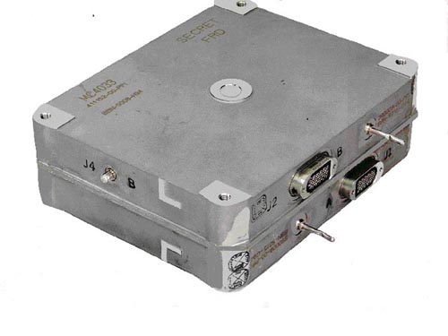

Here are pictures of my "baby". All images are unclassified, and are not sensitive at all. The "SECRET" stamp on the actual radar refers to the classification of the radar itself, not its visual classification

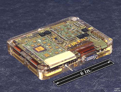

This is the non-rf side of a single clear-pot channel. The large IC is the one that gave us the solder joint trouble:

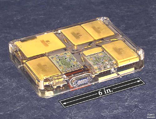

This is the rf side of a single clear-pot channel. Two of the RF hybrids have had the kovar covers removed to show the insides. The hybrids that still have their lids are the visually classified ones because their geometry gives away several different specifics about how it works. The RF deck includes both thick-film (TKN) and thin-film (TFN) hybrids. TKN are produced by oven-curing an ink paste that has been screened onto the substrate. TFN are formed by electroplating pure gold. These are the higher-frequency hybrids:
This is the whole radar as it exists in the stockpile today. It is two channels welded together as mirror-images. The hermetically sealed enclosure is cast stainless steel. Both channels are electrically independent and either can function the weapon:
