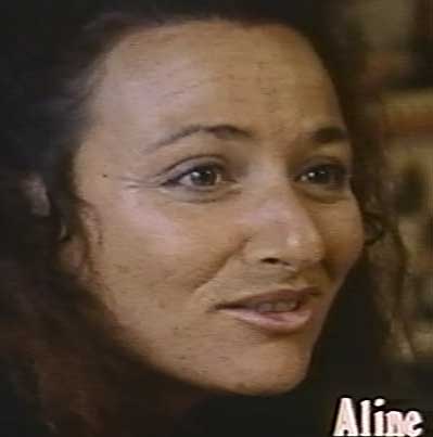

This photo taken from the movie Crumb shows no streaks using my older Zenith VCR

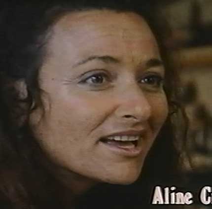

This photo shows the streaks using the Sony vcr.
That's not streaks. That's color banding. But even then, not really. And a horrible image to display it. Not to mention either the tape or her face is terrible. Find a tape with a solid color background, not hamburger.
