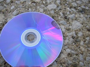

    I was walking outside with a prodisc in hand, when I dropped it. I didn't throw it, it just dropped less than three feet to the ground. I picked it up and it was ruined. Warped rainbow like lines all through the section that hit the ground first.
    I'd say that if these things are really valuable, I'd go to great lengths to keep them preserved. At least make extra backups.

    GizmoTheGremlin, I'm afraid I disagree. Discs are not that fragile. The plastics on commercials discs and recordable media are not very different at all. So therefore, I have no idea what you're talking about. Rainbow color from dropping it? I don't think so.
    You're entitled to your opinion, but I know what happened. I kept the disc.
    I've dropped original DVD's on occasion, and I've never seen anything like this. Believe it or not, it's your choice, but it did happen.
    Back-ups are much more sensitive to scratches than the originals are. This is just my opinion, and it could be wrong, but I'm not changing it at this moment. I've seen originals so bad, that I thought they would never play, yet they do. But I've seen back-ups that still look pretty good, but give major read errors.
    I agree that you should use top quality media, but if this guy chooses to put all his eggs in one basket, then that's his risk to take. I'm in the same situation, but with digital photographs. I keep them on CD's, DVD's and on the hard drive. My photo's are too valuable for me to risk any one thing going wrong and losing everything.

    This disc definately landed on its edge, as can be seen from the pic. but other than that, I can't tell you why it happened. I picked it up, thinking it was fine, wiped the dust off, and I saw that.
    I was completely shocked, I even showed a friend of mine who was also shocked. I drew the logical conclusion that these discs weren't as durable as originals. I didn't put more through any "crash tests" to prove my theory. I just left it at that. Maybe it was a fluke, I don't know, but I know that it happened.
    I'm not sure how you can whack one on the ground and not damage it. I can destroy any disc doing that, and I'm not a big guy. But I do agree that they can be bent quite a bit before they are damaged.

    You may be right. but it was prodisc (MCC media code). As I said, it may have been a fluke.
    All I know, is that I would never recommend putting all my valuable data on one source. This event only solidified that belief for me.

    It was right off the spindle, freshly burned and printed. I was on my way to the garage (it's not attached to the house) to spray a coat of clear gloss when this happened. I wasn't even moving. Almost straight down, less than 3 ft.

    I took a coaster, that I made a couple days ago, outside to test it. I held it down at arms length, stood still, and dropped it on the concrete.
    First time it landed on its back, and there was no visible damage. Second time it landed on the edge and got damaged similar to the disc pic I posted (although not as severe). This disc is also prodisc, MCC media code.
    I'm done testing, so feel free to try it on your own. Smurf, I think you just ordered quite a bit of these, so take your coasters out and tell me if you get the same results.
  14. That damage looks like characteristic shock damage. You can almost see the hemispherical boundary of the shock wave. Concentrating the force of an impact on a small area increases the potential for damage drastically, especially if the concentration is strong enough to create a shock wave that exceeds the strenght of the material.
    I have to admit that I'm surprised you were able to recreate it. I would think that kind of thing would be extremely rare - as in a fluke. Perhaps you put just a touch of spin on the disk (like a frisby), ensuring it impacted exactly on edge. I have a whole pile of Memorex coasters; I might have to experiment myself.

    The second time I did it, it didn't produce nearly as much damage as the first time. But the waves were definately there, and the disc would not be playable (even if it weren't already a coaster).
    I admit that I was trying to make it land on its edge, but I didn't intentionally put any spin on it. The first drop simply didn't land on the edge, but the second one landed perfectly. It even bounced straight up (a little).

    The rainbow effect is from the separation of the layers of the disc. I've seen it when I bend/break coasters I've made. I think Gizmo had the "million-dollar drop," landing directly on the "sweet spot." Probably hard to re-create, but proof that DVDR isn't indestructible.
