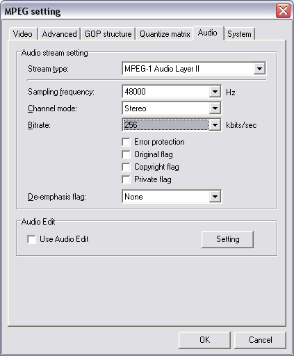

Then set the audio:

hey thanx for replying again. my audio bitrate is 1536 kb/sec and its the only option in the drop down menu, is that going to matter? also on page 4/5 of the wizard it has the output as .m2v and .wav box selected. and its greyed out so i can't de-select it. any thoughts on that? thanx again for taking your time to help me.
and also i just got an error. "linear pcm stream could not outputted as system stream." i used the .wav file that i decompressed with virtual dub as the audio source....
What this is telling you is that you cannot produce a combined system stream file using a .wav file. You have to output this as two seperate streams (an .m2v and .wav file is the end result). This is why that box is greyed out.
Now, if you do it this way, once TMPGEnc finishes doing it's thing, you will need to convert the audio to a DVD compliant format (like AC3), and then load the seperate streams into your DVD authoring program (or you can mux the video and audio stream together to create a single .mpg file that you can load into a DVD authoring app or just play from your computer).
The way around this is to choose MP2 audio on the 1st page of the Wizard. This will take your .wav file and convert it to MP2 and allow you to produce one mpeg stream comprised of both video and audio. You need to be aware that MP2 is not an officially supported DVD-compliant audio format, but MOST DVD players have no problem with it.
