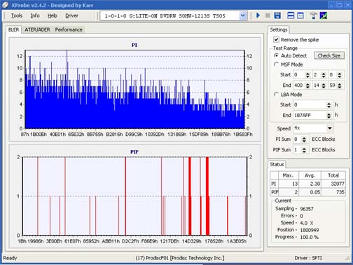

  3. Here is the first test results:
    Date : 9/20/2004 2:12:16 PM
    Model : 1-0-1-0 G:LITE-ON DVDRW SOHW-1213S TS05
    Disc : DVD-R , ProdiscF01 [Prodisc Technology Inc.]
    Speed : 4x
    ECC blocks sum (PI/PIF) : 8/1
    Scanned range : 0 - 1800949
    Sampling count : 96357
    Errors : 0
    PI Max : 13
    PI Average : 2.30
    PI Total : 32077
    PIF Max : 2
    PIF Average : 0.05
    PIF Total : 735
  4. The scan looks pretty good for a Prodics...

    That scan looks pretty good for anything. Now give us some more details, like which burner did you use to burn (brand and model) and at what speed did you burn?
  6. All of the details are listed in the image:
    DVD Burner: LITE-ON DVDRW SOHW-1213S
    Burn Speed: 4x
    KProbe version: 2.4.2

    Ah ok, I just had to make sure. Some burn with a different burner, then scan with their lite-on to use kprobe. That speed in your image is actually your scan speed, but if that's what you burned at too, then great.
    Looks really good.

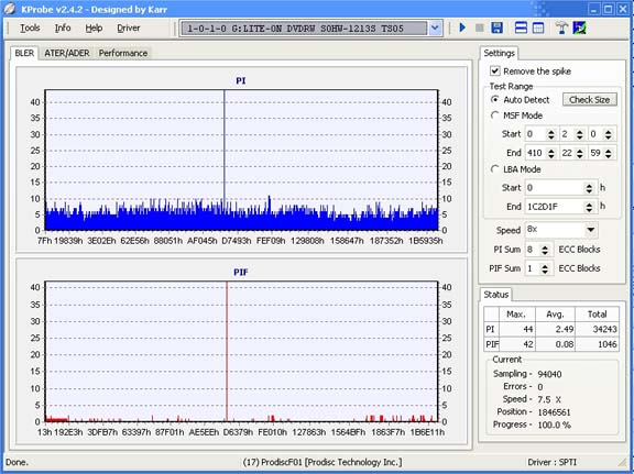

  8. My error. I use Pioneer burners 106 thru 108 with the latest firmware to burn at 2x. I only purchased the Lite-On to test the integrity of the discs. If you would like for me to do an 8x burn on the Lite-On and submit a Kprobe at 8x I can. In a few minutes I will submit the Kprobe 8x results from an 8x burn on a Pioneer 108.
  9. Here are the results of an 8x burn:
    Date : 9/20/2004 4:02:18 PM
    Burner Model :PIONEER 108
    Burn Speed :8x
    Speed : 8x
    Scanned range : 0 - 1846561
    Sampling count : 94040
    Errors : 0
    PI Max : 44
    PI Average : 2.49
    PI Total : 34243
    PIF Max : 42
    PIF Average : 0.08
    PIF Total : 1046

    Still looks pretty decent, except for that little blip.
    You don't have to waste a disc for my benefit. I only meant that if you were going to burn one at 8x anyway (with the lite-on), you may as well post the scan. But I'm content with what you've given us.
