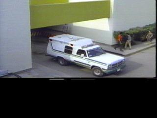

    This is what I get with the PAL setting:

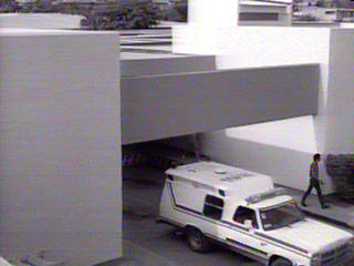

    And this is what I get with the NTSC setting:

  8. Those 2 pictures you posted prove that your VCR is outputting in PAL60, let's have a look.
    When you record in PAL, you get correct colours because PAL60 uses the same colour signal but a squashed look because of the difference in vertical frequency.
    When you record in NTSC, you get a black & white picture because the colour signal is different but the size is correct because PAL60 uses the same vertical frequency.
