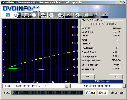

Here are the currant test results if I can upload them
First test is a DVD-r backup I had made, it got alomost 8X read max.
This second is a comercail disk
Looking in the docs, but what is that green line?
So when working properly, what is a true average speed I should be looking for? I mean does a 16x reader get a true average of like 12x, should a 12x get an average of 10x or maybe 8X?
I know I am getting far better than I was at 2.4X, but am I getting the correct speed in now is my question. I have to look up the drive and see what the specs claim, not sure if 12x or 16x read speed?
