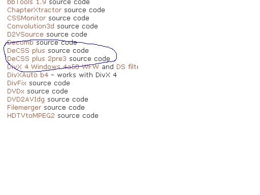

Also check The doom9 download page. There is a link at the top of the page to some free source code for many programs.
The 2 DECSS source codes might interest you but especially the program source for DVDX. This is a complete application including the ripper and conversion to avi and mpeg. I believe it's in C++ so you will have to extract what you need from it.
Have fun.
http://www.doom9.org/
