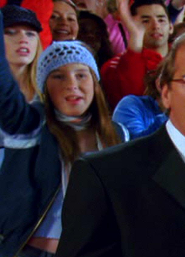

  11. Yes it's the source that counts!
    Example, while not really excellent, I did capture stills using Power DVD from a DVD I created from a VHS-C camcorder tape. Capture from tape was at 352X480 direct to mpeg2 to author the disk with. While the results where alot better than I expected for a still image they were not photo quality. But then the recording itself was poorly shot!
    Capturing from near Commercail Quality DVD however has given me almost photo quality stills! Maybe they were actually photo quality? Depends how you resize and which direction you go. I went larger for a small poster.
    Results were great for what we wanted.
    Both above were captured with Power DVD.
    If I had used a real comercail DVD who knows how good that would have been?

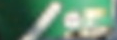

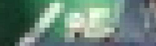

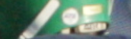

    Actually overload it's not anywhere near photo quality. If your using a good image editor it can produce some good results. When it upsizes the image it fills in the missing info but the image won't have the sharpness and the detail of a photo quality image.
    Here's some examples this first one is zoomed in on a 6.4 megapixel image which is about or beyond what a 35mm camera can produce.
    Same image zoomed in if it was captured from a DVD which is a .35 megapixels, images from the DVD will appear even at less quality that this.
    How the above image looks when it is upsized, like I said a good editor can do a pretty good job of filling in the data.
    Here's a cropped portion of the original 6.4 megapixel image at full quality for perspective on what I'm zooming in on.
    The same portion that's been downsized to 720x480 then upsized to match the one above. This is where the editor comes in and fills in the missing data. edit:the entire image was downsized to 720x480, this image was cropped from that.
    And finally a thumbnail of the whole image, I'm using the kid in the black shirt for these examples.

    Maybe you need a cheap $100 editor like mine....see the third example. Of course this is from an excellent source image.

  17. Actually overload it's not anywhere near photo quality. If your using a good image editor it can produce some good results. When it upsizes the image it fills in the missing info but the image won't have the sharpness and the detail of a photo quality image.
    I think we all need to forget the math and theories which prove things don't work and look at the facts as they are!
    Capture from DVD using PowerDVD saved as BMP then opened in my graphics program was 2pixels to the inch and around 360 inches wide when I went to resample it!! Now exactly WHO is up sizing a 360" wide image??? That I would call DOWNSIZING to 360 dpi and 3"x 4.5" and no filling in was needed to blur the image.
    The above 2 images are cropped from the still image after it was printed on a cheap matt paper, then scanned at 100dpi on a cheap scanner. Can you tell which image is 100dpi and 360 dpi before being printed? Both images had been resized to 3"x 4.5" before printing and the crop was after scanning. Also you are now looking at them about twice or more the actual printed size, each image is only about 18k.
    If I had tried I could have had much better quality.

  18. That is a very small part of a capture I resampled to 4"x6", about what you get from "one hour photo" for a 35mm camera

    This little cut is from an image I sized to 10"wide, cropped this out, printed to dull cheap matt paper and scaned at 100dpi.
    Sooner or later I will get the sizing right so I can get a decent 50k image, this one is about 12k. When I do larger I get way over the 50k limit.
    Hey I got a 49k image
    This one I took a capture, sized to 20" wide, cropped out about an 8"X10" to print, scanned it, cropped out this section of the scan. This image when printed was about 6" part of a 20" wide image.

    This isn't a theory I have it's facts, take a good look at the images and the explanations of each image. To clue you in a little better if you examine the first two pics and there explanations you'll see that it states "zoomed in". These are not images I resized (the 740x480 image was resized beforehand) but images that I zoomed in on and did a screen capture.
    First thing you have to understand is Resolution or DPI has absolutley nothing to do with the actual values of an image. It's a zero, nadda doesn't mean a thing. I can post a 1 dpi image or a 1000 dpi image and they will be exactly the same.
    The only time resolution comes into play is when your scanning or printing. For scanning higher resolutions or DPI will give you more detail. For printing it sets the default size of the image. If you have a 500 dpi image and its one inch it will print at one inch by default. It's similar to to the difference between 4:3 and 16:9 video. They are both 720x480 but don't display at that size. They display at 4:3 or 16:9......
    You can't get more out of a image than what is there, you can mask the flaws btu side by side comparisons like the ones I have posted show the difference.

    It's a 8 megapixel Canon Eos that took that picture (6 megapixel mode), wish it was mine. Really good deal though because it's compatible with the regular 35 mm lenses. I printed out a 8x10 with that image and it looked fabulous. There's a chainlink fence in the background and you were able to see the wires... that's the difference clarity and detail.
    Here's a better example in focus.
    Generally a 300 dpi image printed at 300 dpi produces a photo quality image. To maintain that for a 20x16 inch print you would need a 24 megapixel camera There's other factors such as the printer too. The Eos would produce a image good enough for printing that large, I'm pretty sure it would produce a better image than a 35mm.
    Since your stuck with the source for DVD there really is no choice but use it. Upsizing the image works well but it softens the image.
