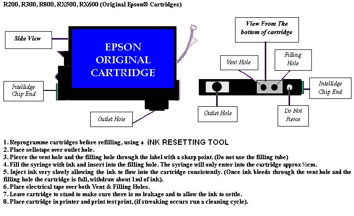

    offline,
    Thanks for the picture. In all my checking I have not found it myself.
    I wonder why then the place selling ink for refilling clains they cannot be refilled? They do sell generics and also empty tanks the say are refillable. Maybe just trying to push they're refillable tanks, but I delt with them before and they don't seam that way.

  9. Yes thanks for that link.
    Maybe I won't be needing many to cut up now
    Naw, probably totally different,
    I'll have to read more of that site and take another look at the carts in my R200. Been so long since I installed them I forgot what they actually looked like, are those the same?

  13. I got a chip resetter on ebay for much cheaper than the sites($8 including shipping). It works great even on the original carts. Its a battery operated thing thats easy to use. Takes about 3 seconds to reset.
    I basically follow these instructions.
    http://www.inksupply.com/index.cfm?source=html/c84refill.html
    My carts are G&G but they are made the same. They use a sponge instead of the system the originals use. Here is what I do thats a little different from the instructions.
    1. Use a safety pin to make the hole at the fill point.
    2. Using a syringe/needle to fill the cart.
    3. I slowly squeeze ink in as I push and pull the needle in and out. This allows air to escape as the ink goes in. I thought about making the whole bigger but haven't yet. If you don't do this the air will make the cart seem full when its not.
    4. When a drop or two of ink start to fall out the bottom exit port your done.
    5. I close the fill hole with tacky glue that can be pealed off on the next fill. Kinda like Elmers glue. I have recently started using electrical tape instead of glue. Seem to work just as good.
    6. It takes about a day for the ink to fully soak into the sponge. You could probably add more ink but I haven't tried it yet. It's best to have two sets of carts so your not down for the one day.
    I've refilled my carts about 4 times with no problems. Prints look great. Got my ink from Mediastreet.
    I have 4 syringes. One for black, one for yellow, one for the reds, and one for the blues.
