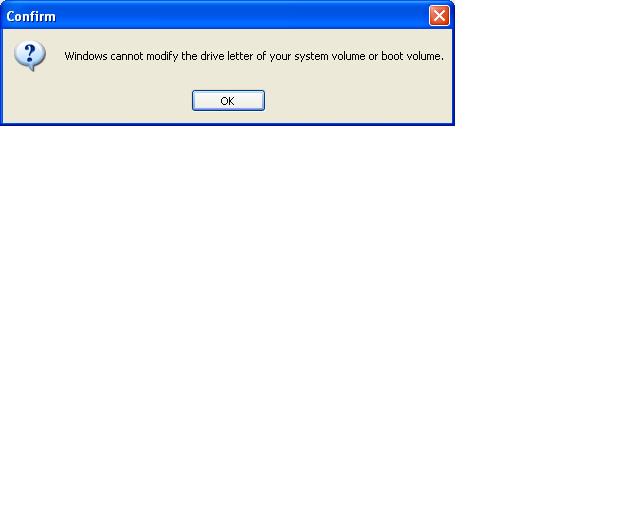

  24. Member
    Nov 2003
    Midlothian,VA
    it wont let me change the boot drive which is currently G. i did go to disk management and have changed plenty of drive letters in the past. i am not sure one can change a boot drive.
    here is a screen shot
  25. i thought about that after i hit submit...
    do you have partition magic? that is what i use(partition magic 8.1)
    if you don't have it (i suspect you don't) try booting into safe mode as Administrator, and change it there. you can also try at command line, but that can be tricky (syntax must be perfect).
    there is an article at Microsoft about it:
    http://support.microsoft.com/default.aspx?scid=kb;EN-US;Q223188
    Please follow the instructions, 'cause your system will not boot if a mistake is made.
    oh yeah... what other drives do you have installed? CD/DVD other hard drives? and their letters?
    Be satisfied, the day is yours. If i have to explain, you would'nt understand.

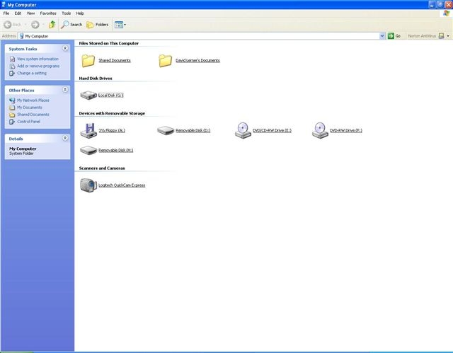

  26. Member
    Nov 2003
    Midlothian,VA
    here is a screen shot of "My Computer".
  27. Member
    Nov 2003
    Midlothian,VA
    i do have i think the latet partition maging 8. if i play with that, can i loose my raid volume???
