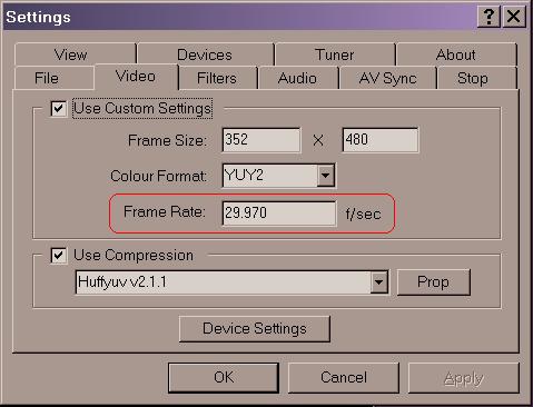

It sounds like your frame rate is way off. Is there a way in your software to control this? For NTSC the frame rate should be 29.97 fps. I think it's 25 for PAL.
If your software has no way to adjust this, then I'd try using VirtualVCR, which does (and is free). I use it with the DVD EZMaker and it works just fine. -

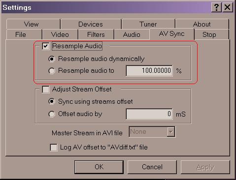

Did you try setting the frame rate to 29.97 on the video tab and checking the check box and setting the radio button for resampling audio dynamically on the A/V sync tab?
in what software now.. cuz now I have like 3 capture software install....... can you give me a detail explanation.. sorry I am a rockie on this.... Thanks for the help.
