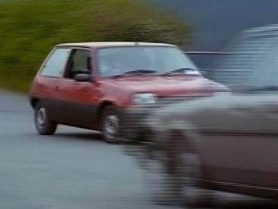

  4. Look at still frames from it with a program like VirtualDub. If you see comb-like interlace lines when things move it's interlaced.
    Don't use a DVD player program. They usually deinterlace as they're playing so you won't see the interlace lines.

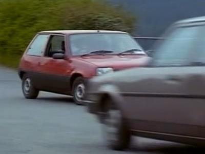

  7. A progressive video doesn't have any interlace lines:
    Don't trust a program to tell you. They often don't get it right.
