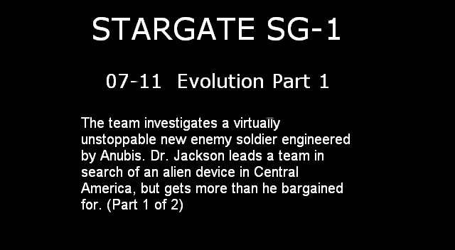

this is what we have come up with as a step by step guide to adding titles to divx files without reencoding
1. make your title and info as a bitmap
2. load your divx clip in vdub
3. set video to full processing mode - choice correct compression method
4. set video - filters add logo filter and choice your bitmap
5. set audio to avi audio and direct stream copy
6. mark the beginning of your intro clip, mark the end of your intro clip
7. save avi *depending on size of intro clip should be very fast (mine was about 5 secs for 10 sec of Divx 5.2.1 video)
8. load intro clip
9. append divx clip (full clip)
10. set video to direct stream copy
11. set audio to direct stream copy
12. save avi *depending on size of combined clip should be fast (mine was about 1 min for 44 mins of Divx 5.2.1 video)
hopefully i didnt miss any steps. this takes about 3-5 mins per episode to add a title to the front of an already encoded DIVX clip.
any ideas on how to improve this process or any other ideas on how to achieve the same effect in less time plz share.

thats gll99 - i think my problem with trying to transcode the intro clip is that i didnt encode the episode clip in the first place my sister did. so for the life of me i cant figure out how she did it. but was able to get the logo filter idea working. i had tried that a couple of days ago but already have the intro clips ready to transcode in vdub and didnt want to redo that. but i was able to simplify the process done with everyone help - now i just wished that i could batch process it so i dont have to do each one seperately. results are what i was hoping for - a simple intro with episode title and short summary
the above is the "logo" i use to achieve the intro i was hoping for -
Glad it worked for you. I like your intro panel it's more complete. My logo didn't have that much info but I got a chance to try another filter by Donald Graph and it's got potential fade out playing with the alpha blend, frame display and multiple instances of the logo. I'll be playing with that next. I'll take a screen snap of your pic and make it into a bmp logo just to see how it looks.
