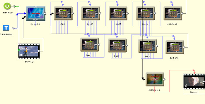

here the prob.
i was doing a dvd authoring using dvd lab.

if anyone can help , here a pics of my connection screen in dvd lab;
maybe someone will find a bad connection or something.
i have succesfully made a dvd BUT WITHOUT the intro movie. so im sure the keypad menu are good and the welcome and secret area also.
so it may coming from the intro link .

OK - you seem to have a number of problems, so let's start at the top.
1. Does your intro movie play on your PC ?
2. Does the compiled DVD play on your PC ?
3. If you author a DVD with just the intro movie, does it play in a settop player ?
The picture is too small to be able to confirm the linkages for the keypad, but the main connectiosn look OK.
As for the sound - what type of audio are you using ?
If you are using DVD Lab standard, then you only have one VTS to play with. You should make sure that all your audio is the same type and bitrate (eg. 192khz 2channel AC-3). If you mix and match audio tyeps or rates, some players may have problems - like not playing some audio.
