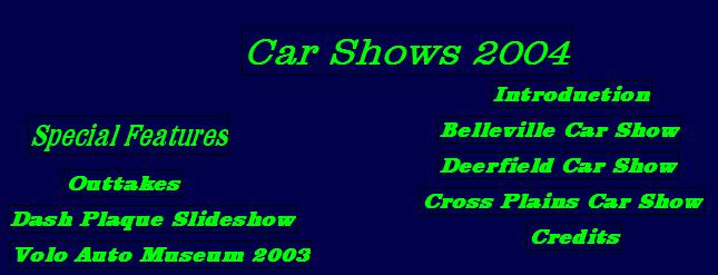

  7. That is exactly what I want to do. To make it easier, let me post an image:
    The Special Features menu would be the one that would play each slideshow and then go back to the menu after each. The menu to right would play all the slideshows through without stopping and then go back to menu. Thanks for the help.
  8. As it seems you want to create only 1 main menu, where some titles will play sequentially, and others should return to this main menu after playing. That is even more easy.
    Again an interpretation:
                           Text: Car Shows
                                                   Button: Introduction
    Text: Special features                         Button: Belleville
    Button: Outtakes                               Button: Dearfield
    Button: Dash plaque                            Button: Cross Plains
    Button: Volo Auto                              Button: Credits
    Do you want/need other menus (chapters/language...)?
    Have all the slideshows (movies) the same properties (resolution, aspect ratio, videonorm)?
    Or in short: Do you need titlesets?
    Assuming the simple case: No titlesets
    Default settings: Untag 'Use titlesets', set 'End action for Titles' = 'Next title'
    Add your movies (slideshows) in this order:
    1. Introduction
    2. Belleville
    3. Dearfield
    4. Cross Plains
    5. Credits
    6. Outtakes
    7. Dash plaque
    8. Volo Auto
    Use 'Create Batch' to author the control files and images.
