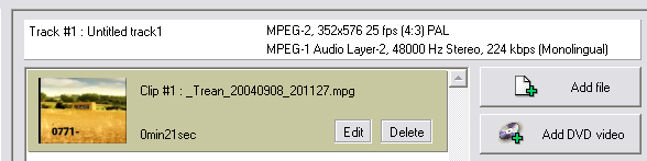

    Why not capture to DVD specs in the first place (I suggest Half D1) to avoid reencoding?

    I regularly capture live TV to half D1 and can see no diff between capture and live when viewed on TV. I use 3500 kbps ave, 8000 max, 2000 min.

    If half D1 doesn't fulfil your quality needs, then go for full DVD res - the point was to avoid the reencoding before authoring.

    Rattlehair, I think you're missing my point: Capture to any valid DVD resolution. I suggest this because it seems to be the reencoding that introduces sync probs. By capturing to a DVD spec mpg, reencoding isn't necessary, it's just to author!

    "By capturing to a DVD spec mpg, reencoding isn't necessary, it's just to author! "
    That’s exactly what I thought and the main reason the vhs was caputered in mpeg format. But........ when using tmpeg and other software it complains that the mpeg is not DVD compliant.

    Well, don't know about your card, but mine captures to MPGs that's just to load into TMPGEnc DVD Auhor and click on "Output".
