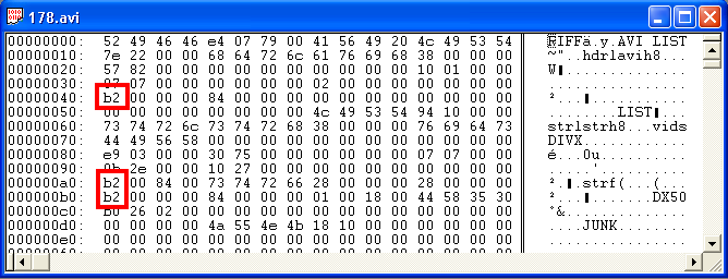

The few AVI header editors I have don't allow you to change the frame size. But you can use a hex editor like this free one:
http://www.hhdsoftware.com/hexeditor.html
Open the file in question
And change the three occurances of "b2" to "b4". Then save the file.
I created a 178x132 AVI file with the Xvid codec. I then changed the fourcc codes to DIVX and DX50. This file plays OK with Windows Media Player, Divx Player, and my Liteon 2002 DVD/Divx player.
I then changed the first occurance of b2 to b4. WMP still played the file and AVICodec still reported 178x132.
I changed the first and second to b4. WMP still played, AVICodec still reported 178x132.
When I changed all three, WMP played the file but the window was black. AVICodec reported 180x132. Divx Player played the file but the image had a line of garbage at the far right (about what I expected would happen since there's no image out there). My DVD/Divx player played the file without any problems. -
Interesting... Ok, I think I made a mistake. It's my height that's messed up My res is 352x178. How do I change the height?
To change the height from 178 to 180 -- either 2 or 4 positions to the right of the marked positions you should see the value b2 (in my sample image the values are 84). Change them to b4.
