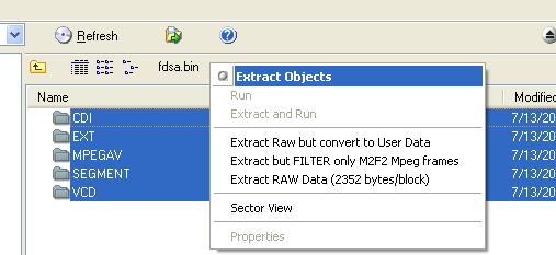

Sorry, let me explain the process starting with avi2vcd. First, import your avi file into avi2vcd. Then set your target mpeg file (output file) and then also set your ntsc or pal (ntsc is united states and canada, pal is europe). Then click encode and let it run. Once you do this with all your tools, download vcdimager and vcdimagergui. Your question is asking about the burning software, and if you are just using the software that came with your computer, it probably will cost you extra for the upgrade for burning vcds, or you can just use vcdimager. Import your mpeg files into vcdimager and set the bin output file. All this will do is change your mpegs into dat files (not true mpegs) and add a few other files so that your dvd player will recognize them. This is stored in a .bin file. Now download isobuster. The open the .bin file in isobuster. You will see something like this with all these folders:Do I need a special vcd burning software??? What do you mean Garibaldi
Extract all those folders to a directory. Then open up whatever burning software you have and select "make a data cd". Then drag all those folders (and only those folders) onto the cd and burn. That's it. What you pay for in commercial software is to automate that process so people don't have to spend the time and energy, plus you can make menus. I am happy to help with any other problems.
