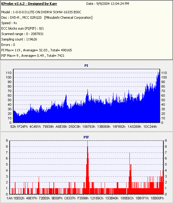

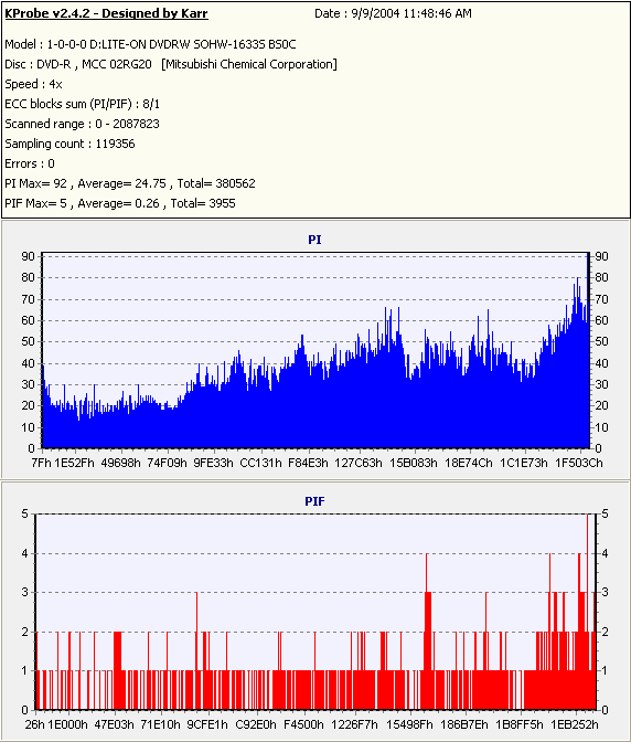

    All right, I finally got a Liteon DVD recorder for running Kprobe. Here are two scans of the MCC02RG0 media, both burnt on the Pioneer 108 with firmware 1.10. The first was burnt at 8x (taking 7 mins 28 secs), and the 2nd at 12x (taking 8 mins 15 secs). Yes, the 8x burn took less time, and it scanned better.
  12. These are average scans; what I have come to expect from Prodisc but not from MCC. Too bad they are dropping quality as well. For some truely good scans on an 8X media with a Pioneer 108 look for Ritek G05s.
