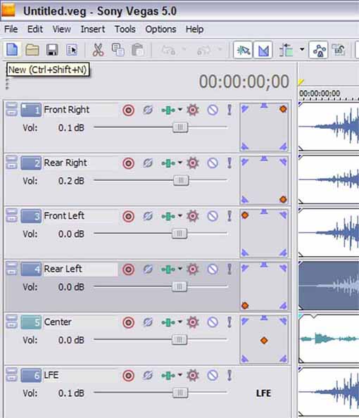

Suntan pretty much summed it up, But I thought I'd add a bit more. My experience is with Vegas (see screen shot) and it's fairly easy to take the stereo output from DV and "fake it" to 5.1. Whether you'd want to waste your time doing this is another story, as other have emphasized previously in this thread. First, you already have the Front Left and Front Right Channels. Second, Vegas and most other similar software will automatically generate an LFE track for your subwoofer from the addition of FL and FR. If you want to use the Center Channel for dialog only it can be made from the mono version of FL+FR by using various filters that accentuate either male or female voices. Vegas also has filters that simulate the ambiance on the RR and RL channels from their respective front channels. Vegas also has some interesting panning options that allow you to use your joystick to pan certain channels. If you were really geeky or bored (or both), you could simulate someone's voice moving through the sound field by panning the joystick to match the action in the video.
One drawback to Vegas. You also need the companion Sony program DVD Architect to unlock the AC3 filter in Vegas. Why this is, I don't know.

Thanks. A while back, I looked all over the Sony website for it, but the link to purchasing the AC3 Filter unlock must be obscure. I just gave up and bought DVD Architect, since I wanted Vegas and already had Sound Forge. -
