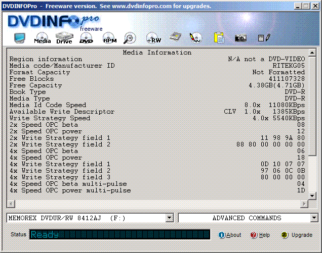

I just received my 8x dvd shipment from supermediastore.com. For some reason, I can only burn at 8x. I use TDA to burn, but to see the capabilities, I get a project loaded in Easy CD/DVD Creator. It gives a dropdown for speed choice, and it only has 1x. Here's the data below from DVDINFOPro: I noticed the Media ID code speed is 8x, but the Available Write Descriptor is 1x. I don't know what that second one means. Could someone please explain this readout to me? Did I get a bad batch of discs? Thanks.

I also enabled DMA already, with no luck. My main concern was the fact that the "Available Write Descriptor" says 1x. I have some BeAll DVDs that I use as a last resort, those show 4x in that line. My Fuji -RW also show 4x in that line. I can successfully burn my -RW's and BeAlls at 4x. That's what made me think it was maybe the disc. But nobody said anything was wrong with that screen shot, so maybe the DVDs are OK.

I did try the Memorex firmware update, but memorex is worthless, and the one posted wasn't any newer. I was successful in converting the drive to a Lite-On. That got me up to 4x on the same DVD. I didn't use the lated Lite-On flash though. I'm now trying to get it to the newest Lite-On. I'll keep ya'll posted. -

You are talking about a problem that is completely different. briandugas provided a DVDInfoPro readout SHOWING that the drive doesn't know how to write at 4x. If this was a DMA/PIO problem, then the drive would attempt to write to the disc at 4x and end up taking 45-60min. briandugas can't even get to that point.

Well, the verdict is in. I updated the firmware to convert the drive to a Lite-On LDW-811s, and applied the latest firmware: HSOQ. Still won't let me burn my 8x media at 8x. I can burn the 8x at 4x though.
Go me. Maybe one of these days the crack team over at Memorex will get off their butts and upgrade their firmware. This makes me never want to buy Memorex anything. All they seem to be good for is shiny boxes on store shelves.
If anyone has any other suggestions, please let me know. I guess I'm just screwed for now. I still don't understand why the "Available Write Descriptor" is at 1x. And the Code Speed is at 8x, and the Strategy speed is at 4x. I read the info over at LordSmurf's website, but this is still just a bit confusing. -

Apparently (according to the DVD Writer section to the left) the LDW-811s only supports DVD-R writing at a maximum of 4x. It supports DVD+R writing at 8x. This info might be wrong, but that's what it says and it explains your issues. If this is true, it might never have firmware that instructs it how to write on G05 media, being 8x and all.

briandugas: if you had mentioned in your first post that your drive was a memorex rebadged liteon drive that would have been more helpful in figuring out why your 8x media could only burn at 1x. liteon 811 can only burn 4x dvd-r media as you've already been told.

You know what? I just examined the box that the DVD writer came in a little closer. The box only has +R for 8x. I feel like a jackass. Sorry to cause all this trouble. I appreciate all this.
I guess I can just buy the +R 8x blanks and do the bitsetting on them.
