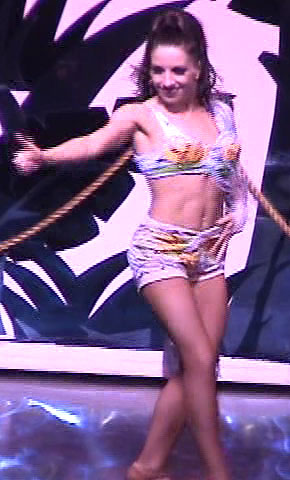

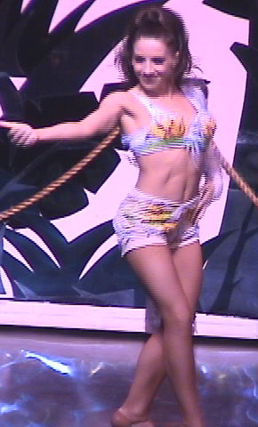

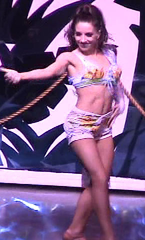

  6. I've come to like AviSynth and will be using that will all of my videos. Even when it comes to trimming the video. Plus, with AviSynth, the special effects can be frameserved in and out of Adobe Premiere. I am the pickiest guy on Earth when it comes to quality. Even colorspace conversions can be minimized to 0 depending on the applications and codecs you want to use.
    well I have always used CCE to do my dv videos and have had nothing but praise for the quality. I am not an expert and do not have time to modify my scripts. Most people including myself can not tell if it is original or a dvd. I did some tests and now it seems maybe procoder is better though. All CCE videos are min 1000, max 8000, avg 4000 with 3pass vbr Q is at 16 of 64 in CCE 2.67. Procoder is in mastering of course. All are B frames(I dont know if that is the frame type I should be testing or not). I see artifacts in her legs and also in the white "v" above her right shoulder with CCE.
    Also C3d did not clean much of this up
    Original:
    CCE:
    CCEwithC3d:
