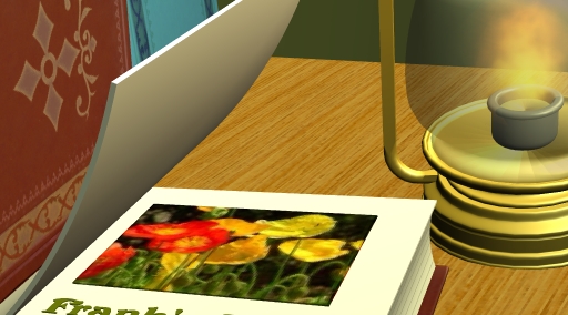

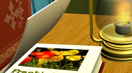

    Excellent work, BJ_M. Even though this is an old post, I just came across it today. I downloaded your clip and tried it out on Main Concept. I don't know what DV codec you used, but Main Concept doesn't like it. It encoded it @ 5x RT, it normally encodes @ 1.7x RT on my old AMD XP 1700. I wonder if the codec effected the output Quality.
    Nice transition from map image to ships image. Definetly a workout for any encoder. All encoders are compromisers and I believe what won out on one frame, may not win out on another frame.
    Now to add more fuel to the fire. I took a frame grab comparison of two encoders on my system. The source video is a 3D animation rendered in Uncompressed RGB (720 x 480). They were fed directly to both encoders, without using frame servers or filters. Both were encoded with 1-pass VBR @ 8500 high, 6000 avg. I cropped to accentuate the differences. I also encluded a frame grab of the uncompressed RGB for reference.
    Procoder - 2
    Main Concept 1.4.2
    Source - uncompressed RGB
    As you can see, Procoder had a very hard time on the flipping page. Main Concept is virtualy indistingwishable from the source.
    In all fairness, Procoder does a good job of all the other frames, just not this one. On the other side of the coin, Main Concept does a great job with all frames. Of course they both look great when played.
    I don't think anyone can really judge an encoder by one frame, but it's great to look at.
