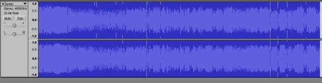

I captured a TV program and the sound is distorted because it is too loud (I think). It might be that I recorded it in 48000hz using Winfast PVR and Pic mjpeg and PCM audio. Anyway here is a wave table of how it looks in Audacity. I seems like it is just too loud, but the distortion remains even if I lower the volume. Any suggestions on how I might fix it? I tried to just de-amplify it in Audacity, but the distortion remained, just not as loud.

From the graph, it looks like the the light blue is what I want and the dark is the volume distortion. Anybody know how to fix this? I think it happened because I had the record volume set to maximum because of a previous capture setting. Forgot to check it.

The bars light blue bars hanging down like icicles or protruding up are indicative of clipping distortion, which happens when you record from a source with too much gain. You can download a trial copy of Adobe Audition which has a restoration tool that will help clean up the noise. The program uses spline curve estimation to recreate the clipped data. It works amazingly well at restoring the audio signal. The best solution of course, is to record without clipping the signal.
The audio will still sound distorted no matter what you do after the fact because it was recorded too loudly; the peaks of the waveform (loudest sounds) were "clipped". There is nothing you can do unless recapturing is an option.
If it is, In a program with a VU meter (your audio editing software is a good bet. Virtualdub and AVI_IO have them too) go into record mode, and while the source is playing/connceted, adjust the audio down until the bars on the meter do not hit the top. Adjust it so that it reaches 75-80% most of the time to ensure that loud noises do not clip. This is the optimal recording level. -

I tried just lowering the amplitude, but it only lowered the volume, but the distortion remained.

Sounds like the audio is most definately cooked. Even if it is not clipped, it can be cooked. I did this once by recording through mic input instead of line input.
If recapturing/re-recording is not an option, then you have to try your best to undo what you have done. That involves trying some different filters on the audio. I've heard of plugins that can help it out, but I don't know the names. Also, they weren't free.

I'm afraid that while some filters may give some improvement, you can't really create sound out of nothing -- the sound was lost when it was captured too loudly and there is nothing to be done about it. The sound that was clipped is gone.

dphirschler; I think the screenshot is after (s)he tried to deamplify the volume in Audacity, which would explain why it doesn't quite looked clipped. Though capturing through mic-in would be bad, definitely! Mic-in is amplified and only mono. -
It doesn't look clipped to me. It looks cooked. Sound from a VCR is often too much for the soundcard's preamp to handle. I run my audio through my DAT deck and adjust the level down. That's before it gets to the PC and has another (final) level adjustment.
As I said, if you can, recapture the audio. This time use something to attenuate the sound. My DAT deck did it for me. Maybe a stereo receiver will do it for you. Maybe you need an attenuator cable (cheap at Radio Shaft). Maybe the solution is running the sound through a cassette deck.
Darryl -
From the waveform screenshot, it appears that the audio is definetly not clipped. Although Audition could most likely fix clipped audio, you don't have that.
As dphirschler mentioned, your audio is "cooked". Don't really understand what "cooked" means in this case, but distortion won't go away by reducing volume.

The dark blue is nothing. The light blue is the audio waveform. Maybe a couple spots clip where it runs into the top/bottom of the meter. But otherwise, it's fine.

Are the louder portions distorted but the quieter portions OK? If so there's probably nothing that can be done.
