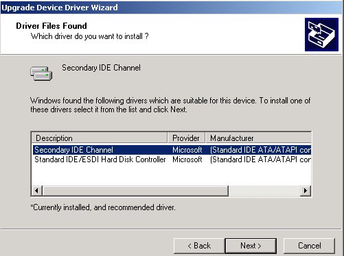

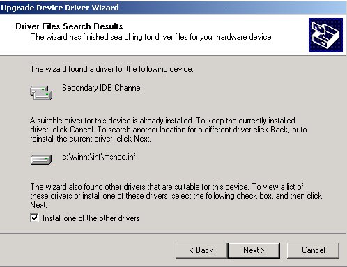

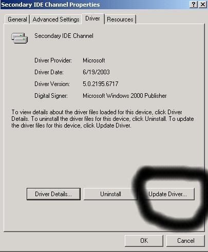

Did you try expanding your IDE CONTROLLER (where your dvd burner is installed on) and followed what I had posted earlier? By clicking on UPDATE THE DRIVER? Here's some pics but it's from windows 2000 pro but essentially the steps are the same. If I'm wrong someone can correct me.I might have a problem when I reinstall XP. I do not actually have an XP disc, but I have HP recovery discs. So I think all the drivers etc are included in these recovery discs.
Yep, it gives me 2 options--
1. Install the software automaticaly (recomended)
2. Install from a list or specific location (advanced)
It always says
"The wizard could not find a better match for your than the software you currently have installed.
Choose what you want to do
To keep the current software, click Finish
To search in another location, click Back"
There is no checkbox to install one of the other drivers. To be honest the update driver button almost never finds any new drivers for any devices when I have used it in the past. budz, thanks for taking your time to help me with this. -
