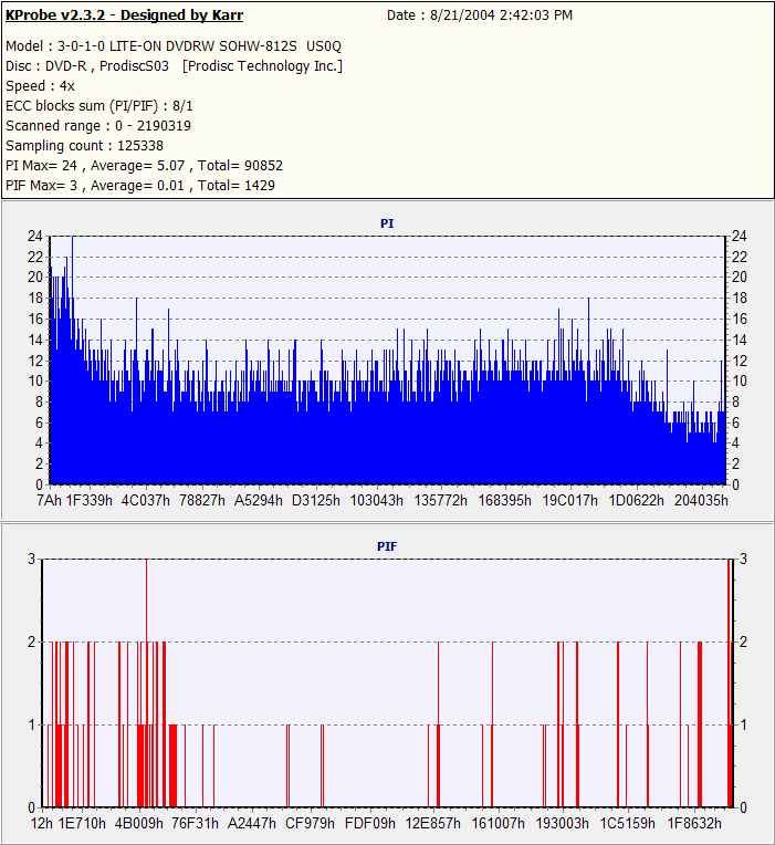

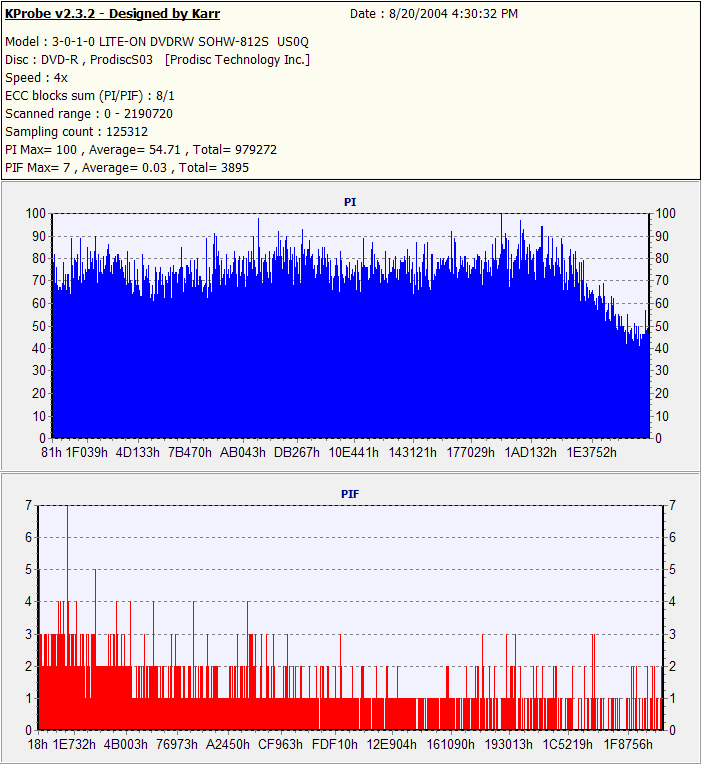

    Look what a little patience will buy! Prodisc S03 at 2X.
    I just received a new batch of Prodisc S03s and was disappointed in the drop in scan quality. I have always gotten scans in the 30-50 range before and now I was getting 70-100. These were still OK for a 35 cent disc but you all know how that goes. We search for the TY quality with the Kmart price. My Liteon did even worse and I was all set to start looking for different burn schemes when I thought I would try a 2X burn. The first scan is 4x and the next is 2X. Both burns are Pioneer 107D with 1.18.
    I think the extra few minutes is worth it.
    Still a few bugs in the system...

    aanaravs:
    Thanks, it is one of the things that make this a great hobby; a little tweaking and a little knowledge gained from other members and a scan to be proud of.

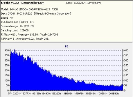

    Here is my scan of new prodisc 4x discs that I got. This is burned with a Liteon 411s at 2x.
    This is the first time that I've used Kprobe, but I'm guessing that this sucks. oh well, plays fine.

    Yes, that is pretty bad. Try reading it at 4x instead at the maximim rate.

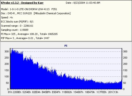

    I did a different disc, just so that I could get more of an average. Here is the scan:
    better, but not close to being level throughout. uggh!!!

    The LiteON LDW-401S/411S/811S drives are known to return much higher errors in KProbe compared to other LiteON drives. I wouldn't worry about the higher number of PI/PIF - you can't compare a scan done on these first generation drives with scans done by anything else. I guarantee that if you scan a disc using an LDW-401S/411S/811S and then re-scanned the disc again using, say, an SOHW-812S, the results will be completely different - with much lower error rates returned by the SOHW-812S.
    Regards,
    TerminalVeloCD

    Quote Originally Posted by TerminalVeloCD
    that's odd, but a bit comforting. Thanks.

    You might move to the FS51. That was my thought as well, but I wasn't familiar with the 411 Kprobe problems. You might want to find someone with an 812 and see what they get on a scan.

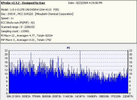

    Ok, now up to FS51. I'm still in mid scan, but I can tell it's definately not any better. It actually looks a little worse. With that link you gave me, I was able to patch the firmware to let me burn the discs at 1x. I presume that would give a better quality burn.
    I'm not too worried about it. all the discs play fine, so i'll keep on trucking. Thanks for the help, and sorry if I sort of hijacked the thread.

    Oops, I was wrong. It ended up being a little better.
    Thanks Chas
    I'm curious though. When I scan at lower speeds, is it more accurate? I'm scanning at 1x right now and the average PI is less than 5. I would think that's good, but I don't know what changes when you scan at slower speeds.

    In general, discs are harder to read at higher speeds. More errors on the disc mean more errors at higer speeds that might have been correctable at lower speeds. Kprobe is run at 4X as this is a compromise to to take less time and still get a meaningful report. Since your DVD player reads at 1X they are able to play because the error correction is working. This is what your very good PIF number is telling you.
    As the earlier poster said, the 411 is not the unit to read your Kprobe scans. Although it might not be so, you might want to get the latest version of Nero CDSpeed and see how it works. Their strategy for your drive might be better. It also just might be that your drive is not adequate for use with Kprobe and the like.
